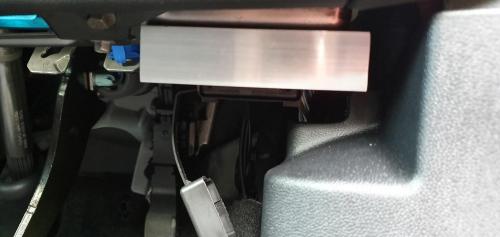

I've stuck a bit of Aluminium angle bar over it.

As the old adage goes, an ounce of prevention is worth a pound of cure. Or in my case £1.99 for the aluminium.
I know it would never stop a determined thief but the opportunist with an obd reader that can convince the car the keys there smashing the front quarter light to reach in to the obd is going to find an obstacle.

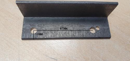

This was my orignial test piece of iron I bought before I got the car. I didn't realise, at first, where the OBD bolt hoses would be. I change to aluminium for the final part.

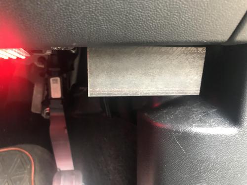

Fitted mine this afternoon. Here is the result.

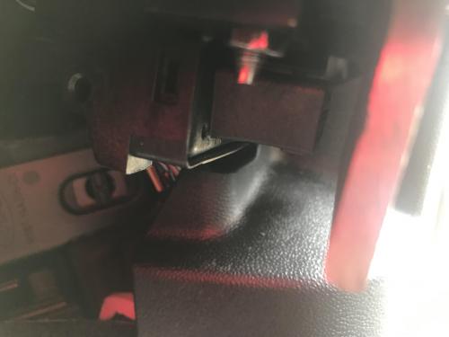

I'm thinking of getting a different sized bar so I can have the cover on the obd as well. Though it's not an issue.

This size would have done that. I drilled the holes central. If i'd have drilled the holes further back i could have put the cover on. Lesson learned.
