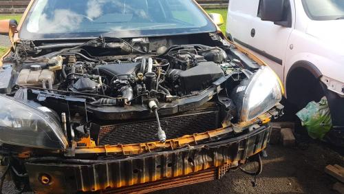

Recently changed engine and gearbox as engines head gasket had gone so changed pcm and clocks and key aswell problem is its like even after getting diesel to the injector pump it will not start or even try its a 2.0 tdci focus any help would be grateful cheers in advance

I could be totally wrong. But the Focus specialist who I take mine to was telling me about when you change the engine - to not change the clock.
Said leaving the original clock in the car will get it to start.
Hope this helps.
Its like tbe diesel pump ant wurking at all on the car
