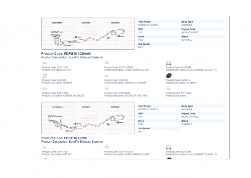

My son has a 2009 fiesta zetec s 1.6 petrol with a decat pipe that we want to put back to standard by re fitting a cat.
anyone know the correct part number for the cat, as there are a couple of different ones on ebay and not sure which is correct
any help much appreciated!
They changed the exhaust system on these in the 07/2009, easiest way to tell is to get underneath the car and look at where the flexi is in the exhaust. Hopefully the diagram below will help you identify it:-
The top image is the early system upto the 07/2009 and the bottom one is the later system 07/2009 onwards
Thanks nick, I’ll get under and have a look cheers
