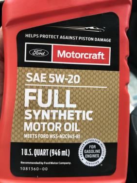

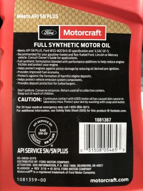

and another thing , the engine oil which they used to replace my engine oil today is the one in the below photos, is it the one suitable for the ecoboost engine ? regarding specs or part number ?
Yep, the oil looks correct - fully synthetic 5w-20 is the recommended oil for the Fiesta/ 1.0 Ecoboost.
