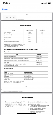

according to my owner's manual ( which I couldn't post a photo for it here because its written in Arabic so I think there will be difficulty understanding whats written  😄 ) the manual states that the recommended oil is 5w-20 with specs WSS-M2C948-B , and if you can't find this spec you can top up with any 5W-20 oil, note that the maximum allowed capacity for the other oil use is 1 litre between services .
the service portfolio which I received with the manual states that the recommended oil is WSS-M2C948-B according to Ford specs or WSS-M2C945-A according Motorcraft specs , all are 5w-20 !!
the dealer uses Motorcraft WSS-M2C945-B1 which I have learnt that its an updated version of the 945-A, it is also 5w-20, so I guess I'm OK.
there is no 5w-30 mentioned any where either in the manual or the service portfolio.
Very confusing with all these specs 😄

Not suitable, only 948-B is allowed for gasoline 1.0L echoboost engines. No alternative oil is allowed according to Ford website. The dealer needs some hard talk!
