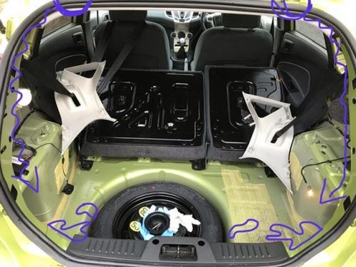

After talking to a few people someone told me to check the bodywork where the rear panels meets the roof and there is a small seam that could be letting water in, photo attached.
can anyone recommend a good waterproof sealer / filler that would suit filling this?
Hi did manage get some sort of selant on .
So I didn’t find a suitable sealant off the shelf that sounds great, I took it to a bodywork garage and they confirmed that the leak was coming in where I suspected. I’ll be taking it to them to be properly sealed and painted rather than find some sub par sealant myself

The seams on the body panels I suspected were leaking (see photos in earlier post) I had this properly sealed at a body work garage. They did a great job in using a water hose to check for sure this was where water was getting in. it was entering the seam and going between the car body work and coming out in the corners on the boot. (See image)
However, when they tested again they said there was still water getting in somewhere else too. They took off the rear bumper and found that in the bodywork underneath, there were holes that should have rubber grommets in that were totally open to the elements. They sealed those up too and now everything is fine
So incase anyone has the same issues, for me I had to seal the rear lights, the bodywork seams just near the hinges of the boot and some holes in the body work under the bumper.
hope this helps others in future if the have the same issue
