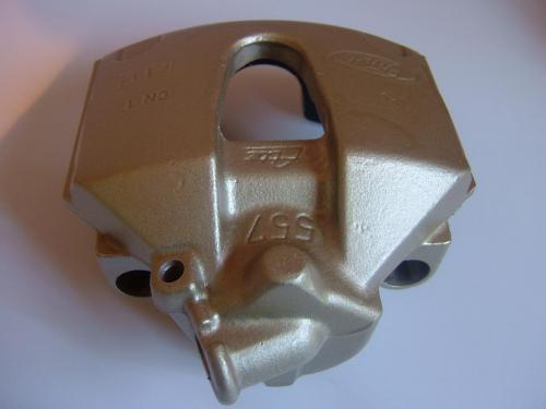

Thanks, the reason for asking, well apart from the obvious looming brake conversion, is that I bought a front "2017" caliper and bracket from fleebay and the other 3 I took off a 2013, when I was going to order discs I noticed that there was 2 different sizes available, both front carriers appear to be the same, as do both calipers, bolt holes in the same places etc, and since both share the same pad size, I'm not sure how I can tell what I've got so that I can order the right discs.
Allan
The Ford brake caliper brackets usually have the brake size casted into the metal.
After a bit of further research I found out that the change from 320 mm to 335 mm front disc brakes was primarily done for the USA market. Other markets (countries) did not get the 335 mm front disc brakes at all or only as an (paid) upgrade.
I have been looking at edc discs and pads, that is where I saw the different sizes, they have an 11-14 section and a 15-18 section, and the 15-18 section dose not have the 320's listed, just the 345's and 271 rears
Here are the caliper and carrier numbers, I'd show pics but for some reason I keep getting a "-200" error
Fleebay "2016"
Caliper bv61- 2b302
Sobka on caliper and carrier
Under piston sp
Carrier
092 >gjs< 1096
And a number 1 under the centre bar
2013
Bv61-2b294
A426m on caliper and carrier
Under piston  aas
Carrier
092 >gjs< 3282
Number 4 under the centre bar
Thanks for the help
Allan
