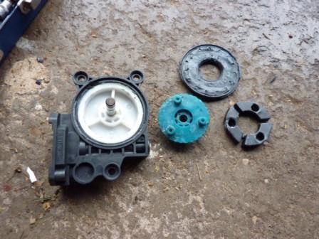

the cog on the back of the window motor has snapped can I get just the cog ? if so where and how does it come off the motor shaft ?
its a 3dr 07 reg is that a MK6 ?

hi folks, just an update I could not get the top off the gear pod to release the broken cog, (could have butchered it, but thought NO) just to see if the cog was same as the one that sells on ebay
so I got the complete unit from here (3 door fiesta) fits a treat, but took 48hrs to arrive not the 24hrs they said
https://www.ebay.co.uk/itm/NEW-WINDOW-REGULATOR-MOTOR-FRONT-RIGHT-SIDE-FORD-FIESTA-MK6-3-DOOR-2002-2008/382918556221?ssPageName=STRK%3AMEBIDX%3AIT&_trksid=p2057872.m2749.l2649
2nd update

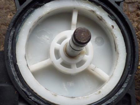

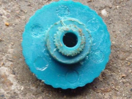

first remove C clip that holds cog on metal shaft (not shown on photos) its just inside top of blue cog

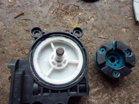

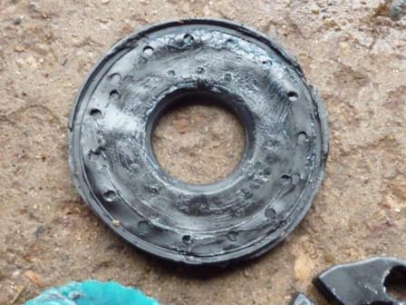

I forced the lid off with flat screwdiver, it holds in to the lip in the base (good view off lip in top right of base jpg)

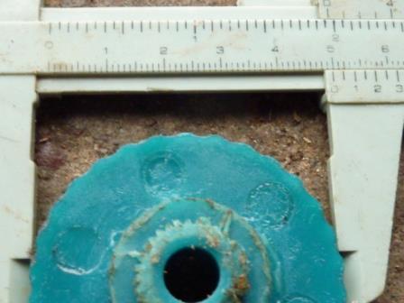

the cog is 50mm wide, its driven by the 3 lugs on white drive fitting into the black drive gear

Hello the goat, your posts have been really helpful in diagnosing the same problem with my mrs' fiesta, thanks!
I was wondering how you remove the c clip that holds the cog to the shaft. The raised wall of the cog is stopping me getting a good grip on it.
Your help would be much appreciated.
Cheers
