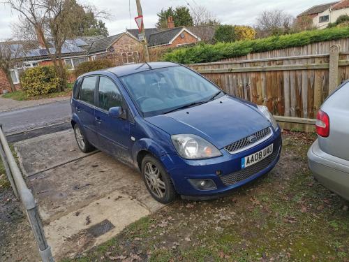

Hi all, due to my main car (Volvo V40 t4) being in the garage for an engine change, and my stopgap car running out of MOT (another V40, just not turbo, but it's a wreck, will never ever ever pass another one) I needed a car quickly, so I asked on the local community Facebook page if anyone had anything for sale for someone on a budget, and within minutes I was offered a 2008 mk6 (6.5?) Fiesta 1.6 Ghia for the princely sum of £300, MOT'd until mid march, reasonably clean and tidy for its age (apart from a small dent in the drivers rear quarter) about 150k under its wheels, drives well with no funny noises or anything, so I bit the man's hand off, quite a good deal I thought.

i had a 1.6tdci 2007 fiesta of same body shape which I got when 5 months old, It didn't had an undertray for engine bay. . I assumed none of them did, but to be honest never checked any others. It does sound a pretty good buy so far. try a different headlamp bulb. I have had bulbs where I though it was connector as they would come on when banged or twiddled with and then found new bulb cures it.
