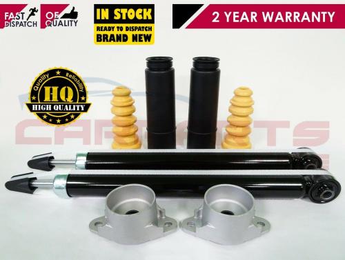

Removed both rear wheels today and couldn't see any tell-tale signs of bushes worn - springs still good - anti-squeak bushes good..... I'm wondering if it is the rear shock absorber and the top mount is at fault ?
