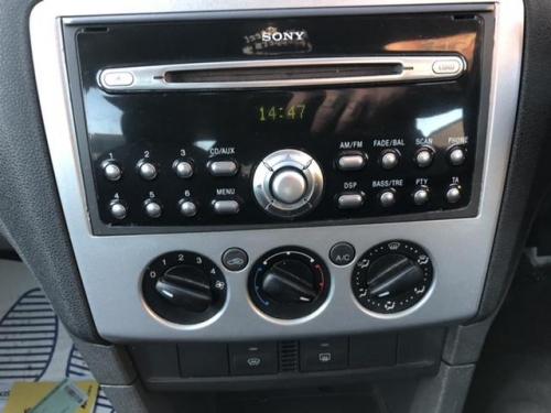

Does anyone know how I connect an aux upto my stereo? It’s an oem Sony head unit on a 2005 focus Zetec climate thanks
Is there not an aux port on the centre console somewhere? Check behind the glove box door too.
If it was fitted from factory, it definitely has a 3.5mm jack port fitted somewhere
You could but the oem Ford kit which is about £20 and needs a hole drilling in the glovebox to fit or buy one of these which just needs the radio pulling forward then simply plugging into the quadlock connector and running out under the radio fascia somewhere-

If feeling a bit more adventurous and you don't mind doing some wiring to a fusetap on the footwell fuseboxthere is a bluetooth kit like this-

No, there is something that looks like a connection in the middle at the back of the glove box but nothing in it. I’ve been told some models didn’t have it hooked up
What you see there is probably the position for the optional glove box cooler vent.
