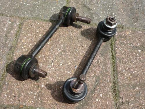

And two more videos showing the sway bar link which i seem to be able to move by hand whether the suspension in loaded or not (which i think should not be the case?)

The sway bar movement is normal as there's a ball joint on each end, however the sound of the first video sounds exactly like one of my car's when I forgot to tighten the sway bar down hard enough, so I'd stick a spanner on there and make sure they're not loose, if they turn just with a spanner on the front (or in this case back) nut then they need a little bit more, if they do move you'll need to then hold the threaded part still by whatever means, ford usually have flats behind it to put an open ended spanner on (usually 15 16 or 17mm, generic image for illustration purposes) and then once it's held give it a good old crank.
If however everything is tight as it should be then it's likely that the sway bar link / drop link itself is had it, I'd check for slack either side to side or up and down as opposed to rotation, a large screwdriver is perfect for this, it could have been on its way out before and disturbing the area doing the bearing change could well have pushed it over the brink so to speak, although unless you're removing the suspension strut completely (which isn't necessary to do a wheel bearing I don't think) then there's no reason to really touch the drop link, it's possible that either the ball joint on the bottom arm or the one on the track rod end has gone but they'd have noticed that when putting it all back together, at least they should have done anyway, a drop link is infinitely more likely.

From the sound alone and without knowing the history I would also suspect the Antiroll Bar/Drop Links. I did suggest the Lower Ball Joint because this would have been undone and could easily have become damaged in the process. To check it you would need to try to pry it apart with a long bar.
It is also worth checking everything else that was removed to change the Bearing including the lower Strut Mounting. It is hard to tell from your video if the Drop Links are ok or not.
Thanks again for the replies, i managed to get the top part of the drop link tightened up by hand without it trying to spin too much. I got it hand tightened as much as i could and then went for a quick test drive. It was more or less the same except it (Feels) like its a bit less frequent now. I think i'll try and get these changed ASAP.

I have installed new drop links both sides which unfortunately did not solve the issue so i ordered a complete lower control arm and fitted that yesterday.
