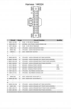

You need to put 2 new wires in connectors.
Radio head to lcd
4 to 6 lcd
5 to 12 lcd
This is the connector  of radio head
20181220_215749.jpg.4ae35ced6fbadb2069d0390b416b39e3.thumb.jpg.8bb70fb0a187b196378d5b7610d1e7a9.jpg
Radio head to lcd
4 to 6 lcd
5 to 12 lcd
