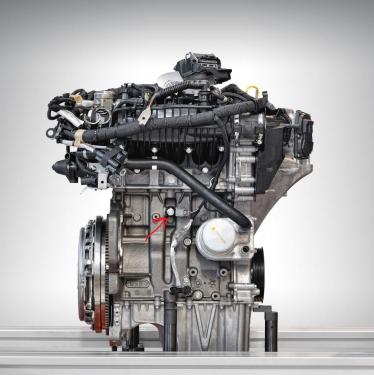

I'm hoping someone can tell me (or show me!) where the knock sensor is located on the 2016 1.0 ecoboost.  I've exhausted the internet in the hope for an image with a big red arrow pointing to the knock sensor, but can't find anything!
Any help would be greatly appreciated.  Thanks in advance guys.
I think it's located on the back of the block , and I think its the one pointed to in the picture below 🙂
Thanks for the info and pic @Eng_Ahmad1986, much appreciated.
Couldn't have been on the front of the block for ease, could it?!! 🙄
Thanks again 👍

I strongly believe its the one in the pic , it just looks like the knock sensor 🙂
You are correct , it is the knock sensor.
