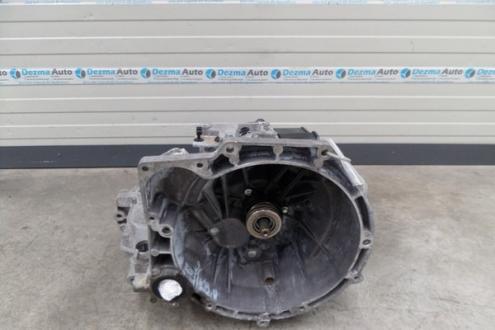

Has anyone tried a gearbox swap of the standard IB5 from a Ford Fiesta 1.6 EcoNetic Diesel 2009 to a 6 speed 1.6 econetic from a Ford Focus Mk3?
From what I see and searched the bellhousing is exactly the same on both of them, and the later one can hold more torque. In the pics the first one is from the Focus and the second one is in the Fiesta. If it's possible this swap can also work on the MK6 Fiesta with the 1.6 diesel engine (HHDA, engine for ex).
I've not seen anyone perform a gearbox swap from one model to the other personally. Looking at both pictures the bolt pattern on both bellhousings are different along the top row, also along the bottom section some of bolts don't appear to be in the right position.
Other issues you will encounter are the amount of splines on the input shaft on the gearbox, I don't know if they are different and also the positioning of the driveshafts.

Thank you Eric! That's a good post. The input shaft has the same amount of splines on those two gboxes from above. I have just checked with some guys.
