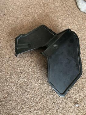

To access these cables & pivots first pop your bonnet and then remove all the air filter box & pipes, then look down at the gearbox and you'll see a black plastic cover, this is simply clipped on, 6 clips lock onto the gearbox casing, when the cover is off, have a good look at the cables & pivots, if it's like most Fiesta's everything will have dried up and gone rusty, you need someone in the car and get them to go through all the gears and you blast everything with WD40, most likely the noise will go and changing gear will become much easier, after spraying the WD40, allow it to dry up, then spray on some thicker/silicone type oil, then refit the plastic cover and airbox.
Cover and selector linkages looks like these....

The pics look like my gearbox linkages which is a 1.4 petrol on a 10 plate, pics just to help you see what might be the problem.

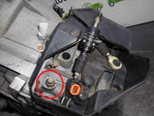

Forgot I had a photo of them, this is what mine looks like the joint the arrow is pointing to seems like wheeler the noise is coming from I don’t think the grease done much the gears do move a bit more free but still hearing the noise

Did you get someone in the car to keep going through the gears as you blasted the cable with WD40 ?

I haven’t had the chance for someone else to go through the gears for me I’ve only tried it myself as I can spray them whilst changing them too, I’m not really sure if the grease is getting right in the joint.
