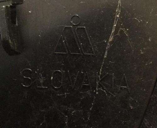

Trying to ID which wing mirror I need to buy and where to get it from.  I have a late 2007 MK5 Fiesta and have removed the old mirror because electric motor has failed.  It is electric, heated and powerfold.  it has these markings on it:  2801-001 RH/11, PFGF30, SLOVAKIA and a capital M with a dot over the top.  Can anyone ID the mirror I need?  Thanks.

None of those are a Ford part number unfortunately.  However, if you can find a used power-fold mirror at a breakers yard, or on eBay, from any other Mk6 Fiesta it should be compatible.

Here is the logo but I cannot I’d the manufacturer.  Can anyone recommend best aftermarket supplier? Van Wesel, Alkar, TYC?
