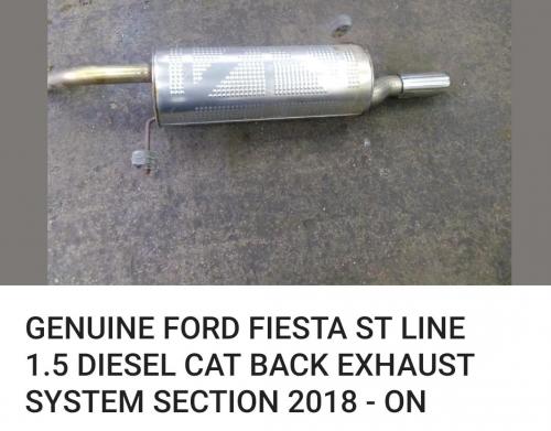

Maybe you are correct- I found this on Ebay- wonder if it would be suitable for use on a 2016 model...
That's for the Mk8 Fiesta, I doubt the hangars and bumper cut-out would be in the same places on a Mk7 but don't know for sure.
They appear to be in the same place but who knows! I'm starting to think I should just get a backbox of a petrol ST MK7.5
