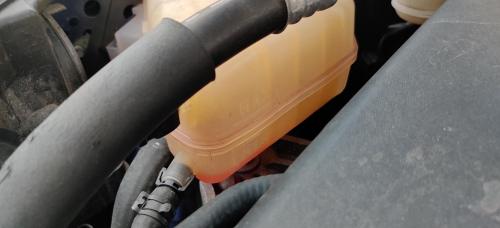

2. When I top up my engine coolant how far should I fill it up if it's nearing empty (picture is after my drive. But my engine was overheating)

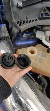

3. I've had this odd engine coolant cap problem now where it snaps my engine coolant cap in half forcing me to buy a new one. What could the cause of this be? I've read it's a common problem and a cheap fix as a first party cap is £10. But it's just annoying to have to replace every 6 months.
Next time you put your coolant cap on smear some silicon grease around the threads.   That should cure the breakages.
Ah I didn't know that.. last time this happened a garage fixed it so do you think they didn't do this? If I top up my coolant now do you think my overheating problem will not come back?

2. Top the coolant up with the correct concentration of water to Ford coolant. Again look in your handbook for the information. Look carefully and you will see the level marks on the side of the reservoir. Your level in the picture is way too low which could count for some of the overheating.
3. Coolant caps breaking is a common problem with sometimes some of the cap stuck in the reservoir. Do as Bob says smear  a thin layer of silicone grease around the seals etc. Make sure you have the correct Ford cap to pressurise the system. Again wrong or malfunctioning cap can cause overheating.
The rubber O rings need greasing as well.

Ford have an upgrade cap but always put a smear of grease or oil on the threads of the cap and rubber seal. the reason the cap breaks is because the cap and rubber seal goes too tight and dry due to lack of use.
Thank you guys! I've done all these tips, back to normal. Fingers crossed!
Grease it once a month (more if its tight to get off) from now on.
