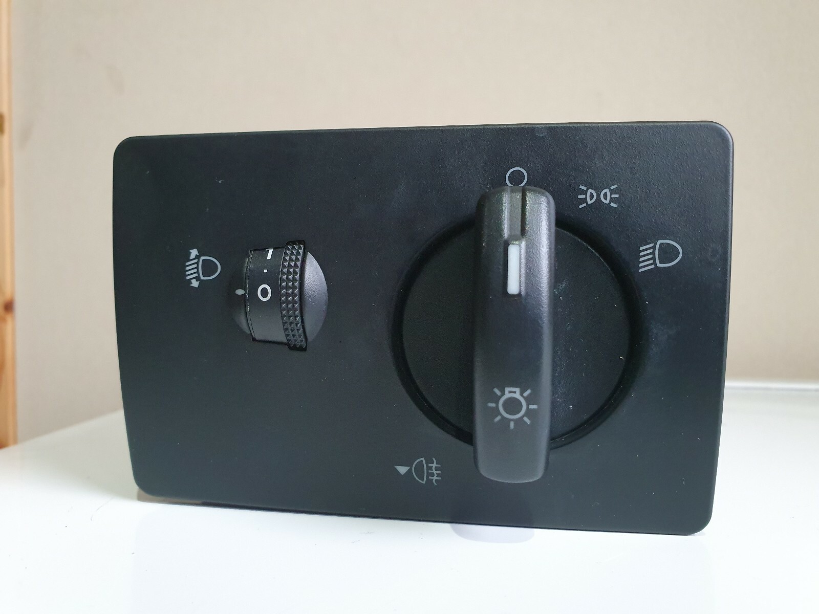

Is this the fog light switch ?
I just realize that every time I drive I crank it to the end, been driving with fog lights on all the time then.

Isn't it pull out for fog light?
If you've been turning it to the 2nd position after 0 then that's just normal headlights.
i also reckon you pull it out towards you for fog light, and that will also show you a warning light on dash (cant remember if the warning light is in speedo or rev counter). it would have failed the MOT if it was not working OK before (fog light and the warning light are checked)
Passed my MOT last week, I will check tomorrow and update.
It worked, I did not know you have to pull it out. It worked on the driver side, now I just need to get 2 wires to connect the reverse light and fog light to each side. As driver side has fog light working but no reverse light and passenger side vice versa.
