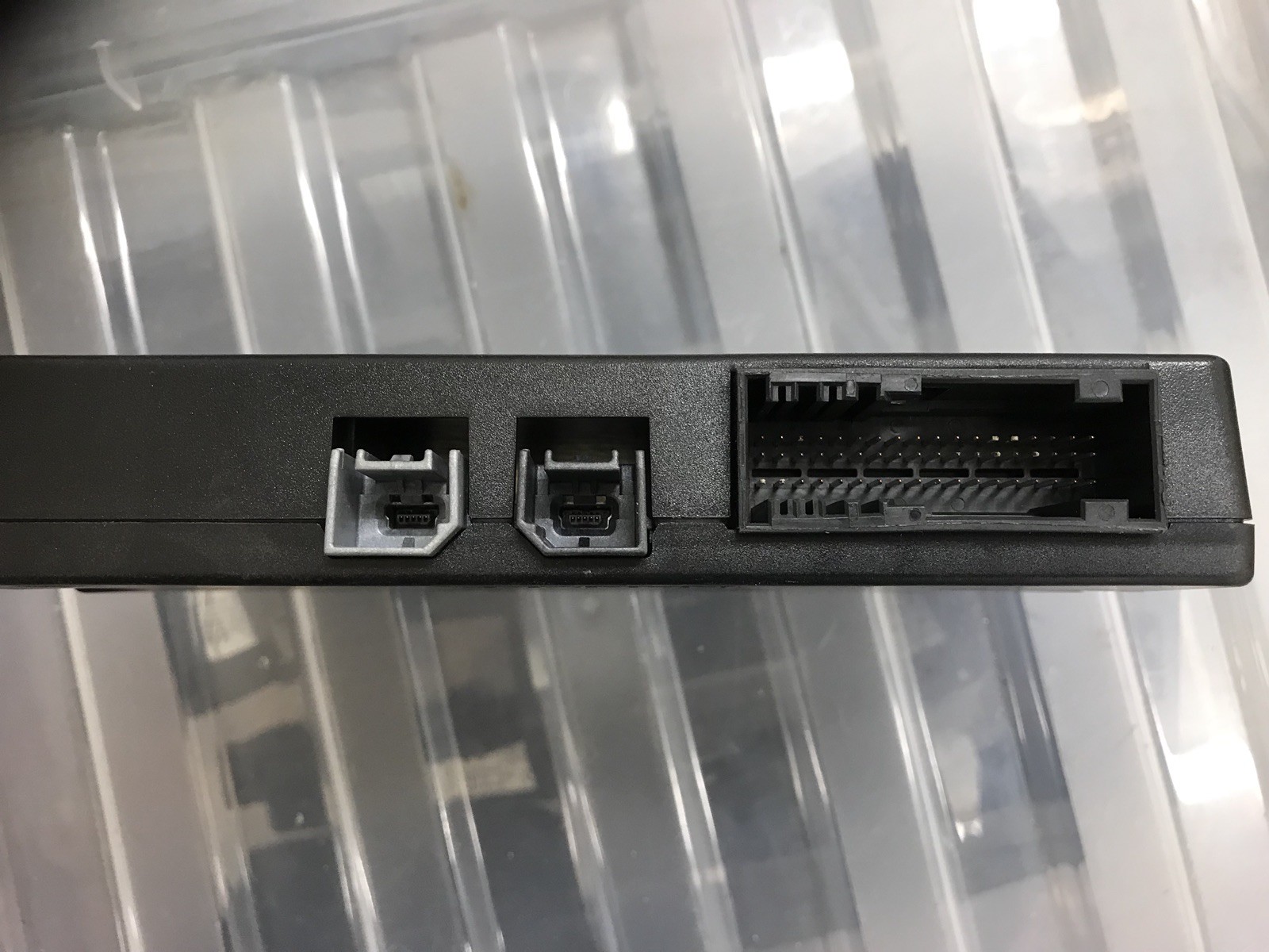

I found this module on ebay.

1 hour ago, avlad said:
I see! Therefore in order to add Bluetooth to my car I only need to buy a module and fit it under the passenger footwell and change the fascia in order to have the phone connectivity button, or I need to do something else?
Sadly it's not that easy...
First thing's first, the picture you posted is of a SYNC module (basically fancy bluetooth) that is used on the facelift models. I've never seen anybody that has been able to fit that into a PFL model.
You need the regular bluetooth module for the mk7 rather than SYNC. Then you also need the microphone, panel for the roof (which houses the mic), indicator stalk with voice button, the larger stereo screen, fascia with the extra channel buttons as you posted above, and wiring looms (this will be the hardest bit to get hold of).
Once you've fitted all that you need to activate it using Forscan.
