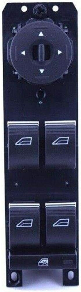

Has the mirror button been moved. it can move to the left or right or in the middle.
Does it look like 1
or 2
Hope this helps

Hi
Does it have a switch like this
Window Control Switch with Wing Mirror Switch (Folding) AM5T14A132AA:  Amazon.co.uk: Car & Motorbike
Or like this
MK7 power folding mirrors question - Ford Fiesta Club - Ford Owners Club -  Ford Forums
If its like the second switch the toggle can move left/right or in the middle and then by pushing the down switch when the toggle is in the middle the mirrors should fold electrically.
Hope this helps
