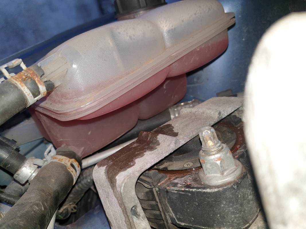

i have just made a thread about my leak few days ago, mine was leaking at the very same spot as yours if that 'oil' is coolant.
i just changed my tank yesterday as i had a tiny crack and it was leaking on that round thing same as you.
look under the tank and see if its wet.
this is what happened to mine:
Tank is dry, don’t know what this black thing is, I thought it was an engine mount
i dont know what it is either.

1 hour ago, K9s said:
No white smoke. But did notice oil in the middle of the black thing under the expansion tank. Don’t know what it isE5D305A7-F6E0-4095-A73B-785DE4973A6B.thumb.jpeg.f107a46833a8e32b80daa1e952d6c78a.jpeg
That engine mount is hydraulic.  There's oil inside it to smooth out engine vibrations.  Once the oil leaks out, it can't be repaired, just needs replacing.
Thank you, something else to sort out 😮💨
