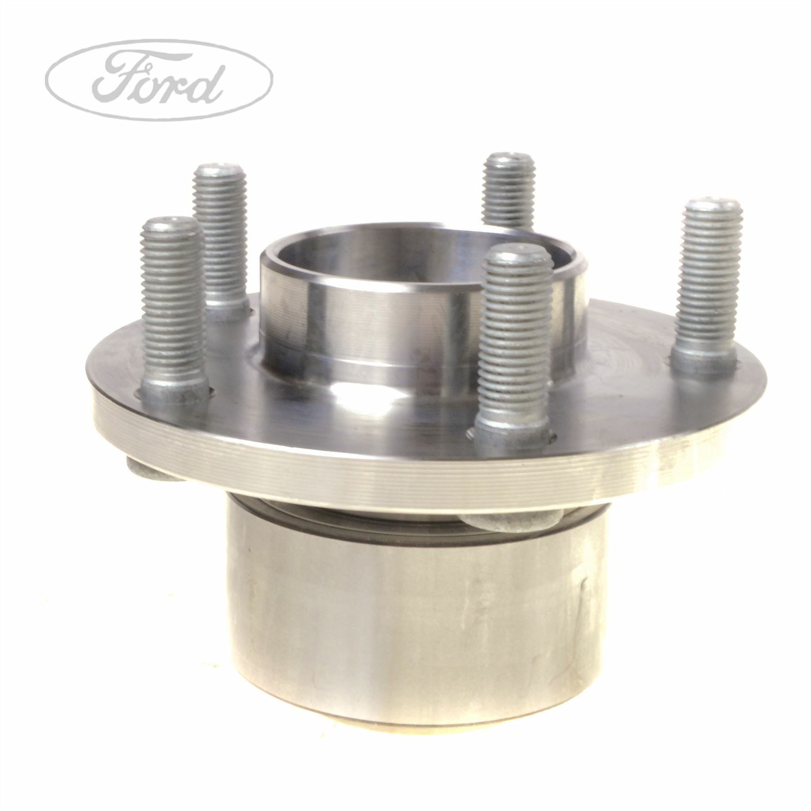

Ok, so I can't find the exact stud length, however I have found some interesting info.  The Galaxy uses longer studs as well as longer headed nuts...  The actual seat of the nut appears to be the same shape though.
Galaxy hub:
Picture 2 of 4
Focus hub:
Picture 3 of 4
Galaxy nuts:
Picture 1 of 4
Focus nuts:
Picture 1 of 4
