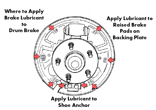

The first thing you need to do is get a can of brake cleaner and spray it all clean. Then lubricate all the anchor points as per the backing plate picture below all the ledges where the brakes touch need lubrication especially the sides of the bottom middle bit where the bottom of the shoes make contact.
would i need to take the whole assembly out or would i be able to lubricate with the things still in if i can pull them out abit?

It can be quite hard to do it without getting it on the brake surface. I tried that my self once without removing them but removing them gives you a bit of experience. Removing the retaining pins will give more room but be careful to not get it in the actual brake surface and also don't press the brake pedal whilst the drum is off or the cylinders will pop off the ends and start spewing out brake fluid. It's also a good idea to rub of any excess rust on the plates with sand paper then do the brakes cleaner again then grease. Yes that grease is good enough.

werent sure where to lubricate so found this picture to help me and others:
Yes was trying to find that one 🤣
