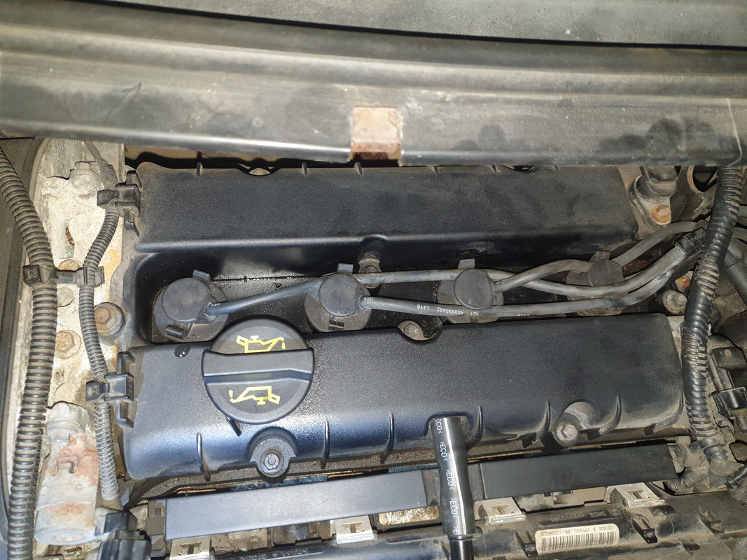

i have replaced my spark plugs few days ago and noticed surface rust in the spark plug cavity. the thing is i dont actually know when water was in there but last night its been raining all night and been driving around for few hours for testing purposes and although few drips went on the ht wires and some drips in the plastic part (don't know what its called) where the ht wires are, the spark plugs and the well was dry.
i am not sure if the previous owner did an engine wash and water somehow got in the spark plug well and they didnt dry it out and just left the water in there.
even though last night seem good that no water went in the cavity, i would still like to stop the drips though.
as you can see how much rust in the cavity:
i have read that some people went for the revised jet washer or just use some sealant but where do i apply the sealant though?

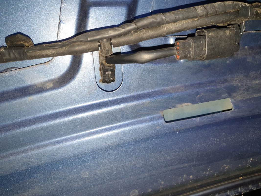

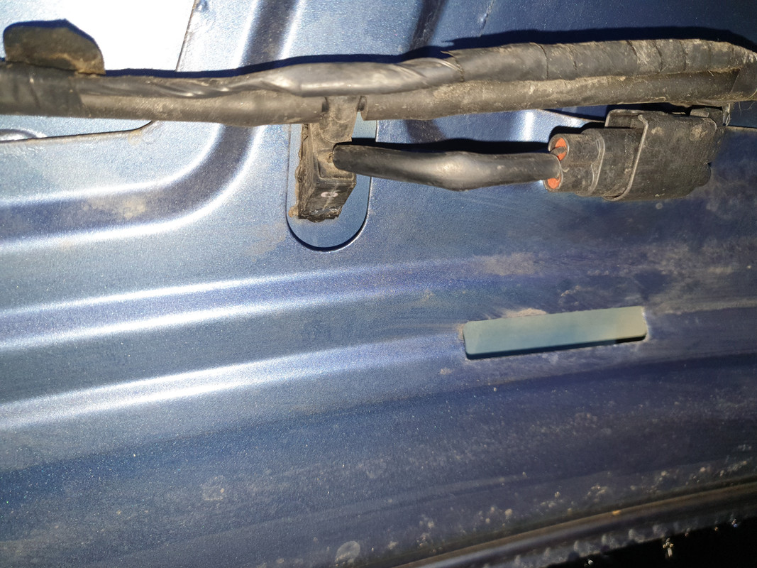

push the washer jets out from the bonnet and apply silicone grease around the base of them before refitting or buy a volvo c30 top engine cover .. lots of info on the topic if you do a search .. silicone grease method has worked for me for the last 14 years

thats exactly what i have done ..put silicone grease around the underside lip of the washer jets then push them back into the bonnet ..a lot of others have bought the volvo c30 top engine cover ..it covers the spark plugs to stop the water getting in .. its only the 1.6 focus thats affected as the engine sits further back and the sparkplugs are then under the washer jets that leak when it rains .. the only reason the upgrade to spray jets works is because they have a foam gasket between the jet body and the bonnet

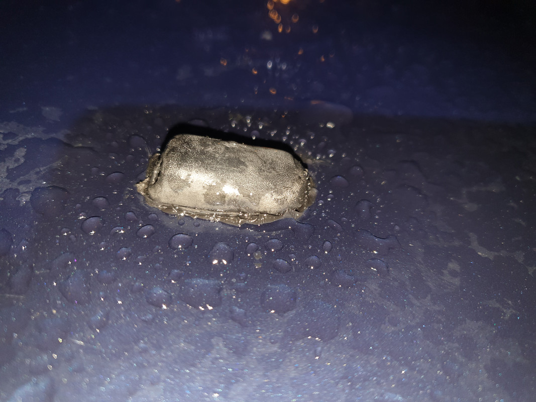

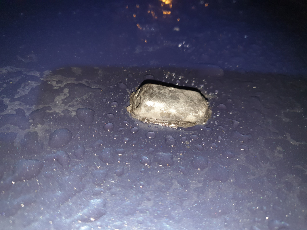

update guys:
popped the bonnet before i drove the car tonight and there was a small puddle where the ht wires are, as i had only sealant in car i thought i would try that out first.
made abit of a mess but i can cut bit of it off to make it look better. the rain was quite hard tonight and i waited for 30 mins to see the outcome. it was leaking slightly on the back of it which i didnt seal. i only sealed the top.
i will have another go when i get some silicone grease.
i was going to get the rocker cover but i dont have the bolts where it should be:
You will get a better result if you actually remove the jet from the bonnet and then apply the sealer on the contact face.
It is fiddly to disconnect the jet from the bonnet, slide it then push up. Once you get one out and look at the clip it will be obvious.
I did mine many years ago and never a drop since.

i have decided to get the revised jet wash and try that out instead.
does anyone know the part number for the revised one please?
the spray mist is weak.. i used the silicone grease and had no trouble for almost 14 years
ahh ok, i have ordered it earlier then realized it might be the wrong one. i have a wire sticking out at the bottom bit below where the hose joins unless mine comes out but i have tried and the wire wont budge.
non heated will still work, just remember to cover the leads up when you unplug them as you won`t be needing them again until you invest in new heated washers. hope you won`t have too much trouble removeing the old one`s now that you stuck them down with sealant.
