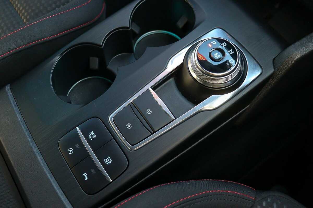

So I’ve just bought a Ford focus St Line X 2019
One of the led rings at the bottom have slipped and is leaving a gap which money and stuff has fallen through I know if I take this to a garage they’ll charge me a killing for a simple quick fix I just need advice how to get the plastic centre peice up without breaking it
any advice is appreciated
No real tools required, although a plastic trim tool might save your fingers. The whole centre section just pulls up with a good strong firm tug.
Thankyou!!!
I would use a blob of BluTak in the center and see if it will just pull up the plastic circular bit...
