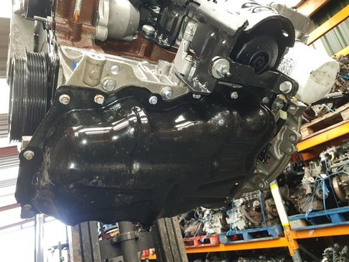

Yes, fuel filter is underneath on the 2.0 Ecoblue S-Max/Galaxy.  Slightly different to the Transit though.
2015 On MK2 FORD S-MAX COMPLETE ENGINE 2.0 DIESEL ECOBLUE YMCB ONLY 18K MILES - Picture 11 of 12
