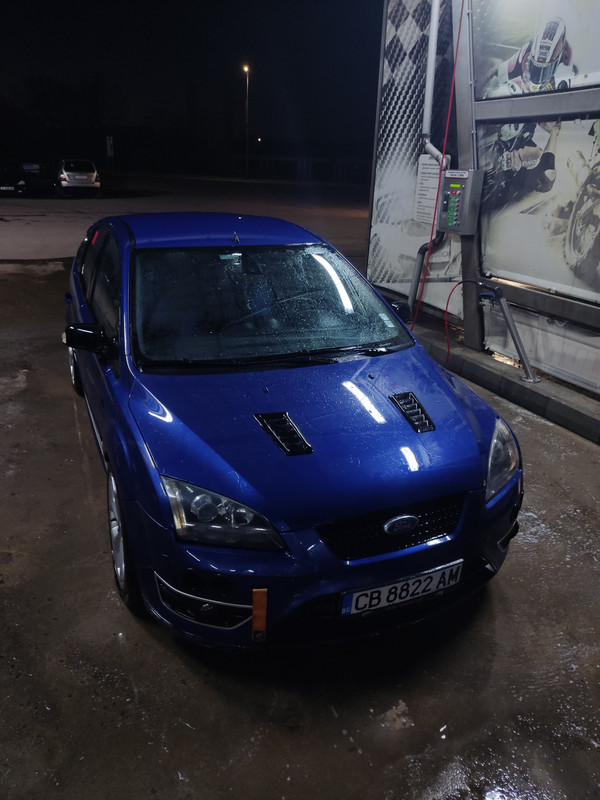

spacer.pngHello! I own a stage 3 ford focus mk2. The issue im facing is that sometimes under heavy loads or when fuel tank is low on fuel the rpms go only for 5k and it cuts, then the ESP SYSTEM fault comes on and lowers the performance. When i restart the car everything goes away as symptoms. The thing i noticed is that when i unplugged the maf sensor (i think that's how u call it) (located on the air intake before the air filter) the ESP system fault comes on. It is strange to me that maf sensor is related to such fault on the dash. Is the cause the sensor? What could be the cause? What is that about the tank being low and car stutters at high loads? Thanks beforehand!
