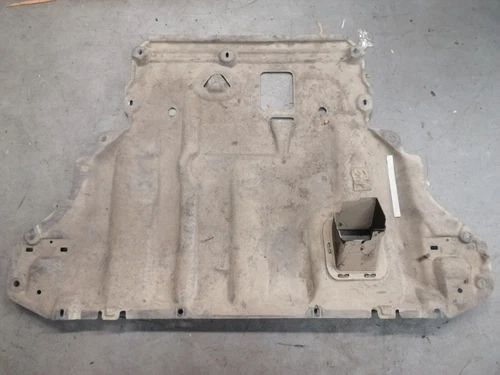

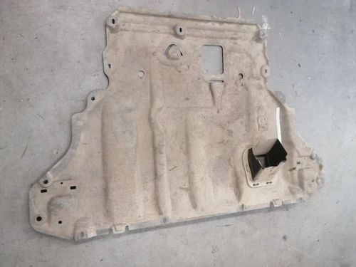

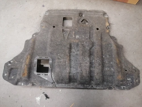

From my memory I think there should be another small bit at an angle to deflect the air to the correct part of the Gearbox that may have broken off but I'm not certain about that.
The angle deflector goes above the undertray.  You will probably need to remove the tray to push the two parts together again.
Ford Focus Under Tray Cover Shield Front Bumper Engine ST275 2019 + Onwards MK4 - Picture 1 of 5
Ford Focus Under Tray Cover Shield Front Bumper Engine ST275 2019 + Onwards MK4 - Picture 5 of 5
Ford Focus Under Tray Cover Shield Front Bumper Engine ST275 2019 + Onwards MK4 - Picture 3 of 5
thank you so much for your detailed images!
now I understand.
I have to check if this part is inside..!! I can hear the last days a banging noise when falling in pits but sounds more metallic. Will check!
