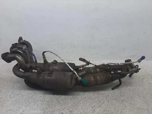

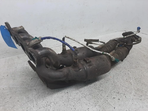

If it's a 1.6 Ti-VCT then it'll use two catalytic converters side by side.  Each cat has a pre & post sensor.
Yeah, it has a left and right cat, two cats, each with two sensors totalling 4 sensors. The issue im having is locating the sensors as all the videos I've seen, the upstream sensors are on the engine block at the back, but my car doesn't have that. I've had the downstream sensors changed already, it's both Sensor 1 I'm trying to find
The sensors are right on top of each cat.  Really awkward to access.
2015 FORD FOCUS Mk3 1.6L Petrol PNDD CAT CATALYTIC CONVERTER  - Picture 1 of 9
2015 FORD FOCUS Mk3 1.6L Petrol PNDD CAT CATALYTIC CONVERTER  - Picture 2 of 9
