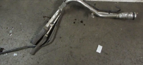

What does the breather pipe actually look like?
I recently posted a video showing how to remove the petrol cap lock mechanism.
All I can see in the video are two stainless steel pipes. Is the problem caused by the smaller pipe being blocked?
Looking at some on ebay, the smaller pipe is welded to the side of the filler neck at the top end.
13 hours ago, AntonovAN12 said:
Thanks for the reply.
My apologies, I confused myself last night.
You are right about the 3rd charcoal canister pipe.  It does act as a vent while filling and should also allow air back in as the tank level drops.  This is a Mk3 filler but looks the same as Mk2, with the bent plastic line being the one from the charcoal canister.  If you disconnect the other end, you could try blowing through it to check if it's clear.  There may be some dead insects in there if not.
ford focus 1.6 petrol fuel filler neck 2011 - 2014 | eBay
ford focus 1.6 petrol fuel filler neck 2011 - 2014 - Picture 1 of 12
The smaller metal pipe is the main breather to release large amounts of air while filling.  It would take ages to fill with only the tiny pipe releasing air.  But as that one exits behind the filler cap, may not allow any air back into the tank from outside as the level drops.  (Having said that, I'm not sure whether the filler cap has a two-valve on it - my Focus's were all the capless EasyFuel system).
There are some 'mechanical' vents on top of the tank for both the evap pipes and the large breather pipe.  They use springs and/or floats to close the pipes when the tank is very full, and should open again as the level drops.  You may find the large filler vent is stuck closed if the problem isn't with the evap system.  Sadly that's not accessible without dropping the tank.
