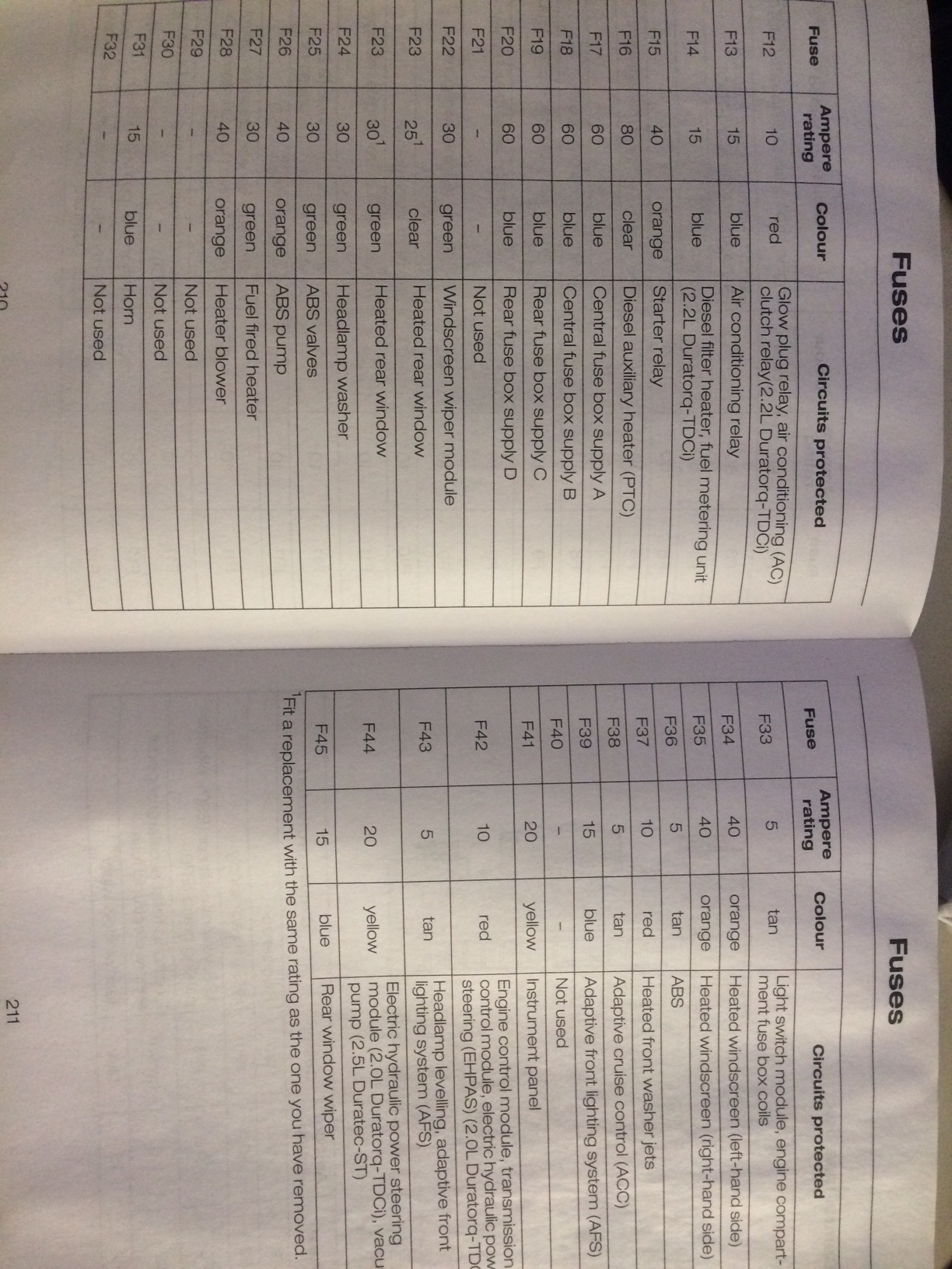

On 9/11/2019 at 7:13 PM, TheOneAndOnly said:
Hi All,
Having an issue with my S-Max recently where it could start and run no problem for a few days(or more) then intermitenly not start, even if left over night.
It then may start after 2-5 goes of turning over.
I've gone to two mechanics, full service, brand new battery, diagnosic computers show no codes at all.
They're both stumped, they've said its not the fuel pump or an air lock.
This is a video;
https://youtu.be/-RrkkMadu7w
Here is a pic of the fuse box, does it look right?,
https://i.gyazo.com/a3a86ac9e85d5bf72659a795d9003869.jpg
I'm at a total loss here and any help would be greatly appreciated.
My other half is afraid to death to drive it as she's scared it wont start when she parks up on the school run or going to the shops etc etc.
