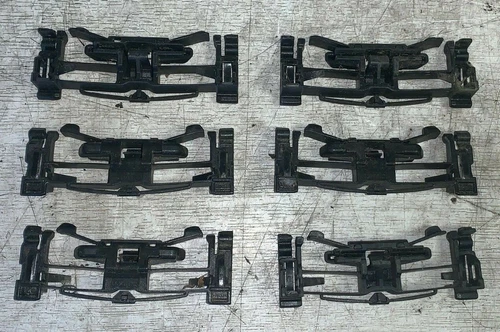

They do just clip on.  There might be some adhesive at the ends as well.
The clips look surprisingly elaborate for such a simple part!

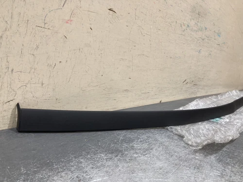

Ford Focus Roof Gutter Trim Clips Set of 6 2011-2018 MK3 11-18 | eBay
Ford Focus Roof Gutter Trim Clips Set of 6 2011-2018 MK3 11-18 - Picture 1 of 9
New gutter trims come with new clips, but they are over £100 each.  They are also different for hatch and estate so you need the right ones.  One hatch trim linked below.

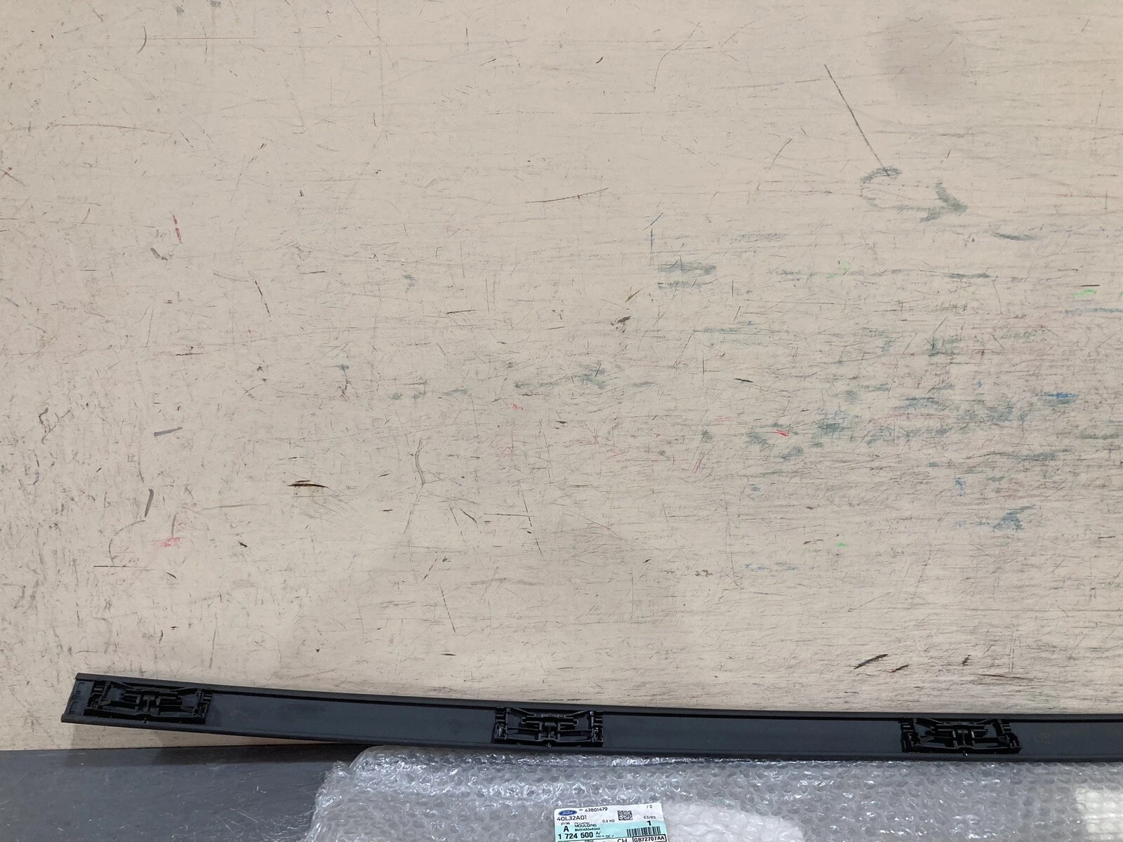

FORD FOCUS MK3 C346 Right Roof Strip Trim BM51-A50462-AG GENUINE WV-1224 | eBay
FORD FOCUS MK3 C346 Right Roof Strip Trim BM51-A50462-AG GENUINE   WV-1224 - Picture 3 of 8
FORD FOCUS MK3 C346 Right Roof Strip Trim BM51-A50462-AG GENUINE   WV-1224 - Picture 7 of 8
Must admit I thought they were just plastic.  But I guess they must have an aluminium core looking at your pictures?  I reckon they're made to such a tight tolerance that wrapping won't allow them to refit.  And paint doesn't easily stick to aluminium.  I wonder if the best idea is just to carefully remove a better condition pair from a breakers yard.
