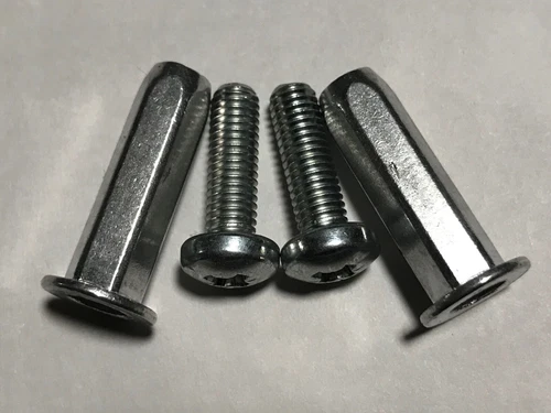

Hi All, daughter's mk6 rear number plate has lost a screw, and she's asking me what type of replacement she needs to get..... is it the self-tapper type screw or the one with a backing nut she needs to buy, Halfords have both.... thanks!  btw, she's not local to me so I can't investigate.
Should be a machine screw on a Mk6.  They have a long threaded nut in the tailgate like this.
C-MAX GALAXY KUGA TRANSIT S-MAX FOCUS VOLVO REAR NUMBER PLATE PLUGS & SCREWS NEW - Picture 1 of 5
"Official" fitting should be as Tom suggests. Problem can be that when the car is first prepped when new, or if replacement plates are fitted at some point, the fitter may not use the captive mounting.
I've had more than one experience, even on new cars, where they have ignored the factory mounting points and just drilled through the plate and into the metal of the tailgate and used a self tapper!
Over the years I've built up a stock of the various types of fixings so can usually deal with anything. You don't really know what you will actually need until you remove the plate entirely, though, and see whatever bodge lies beneath.
