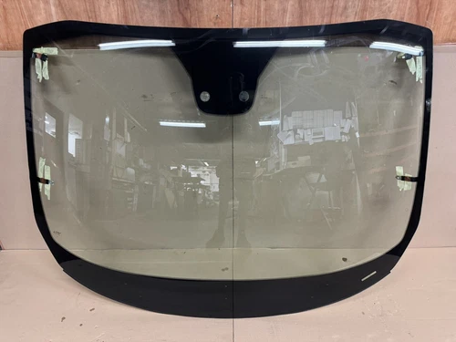

I can't find a Tourneo glass online quickly but have found this Transit Custom glass of the same era that shows the cable locations clearly below the A pillar trim.
