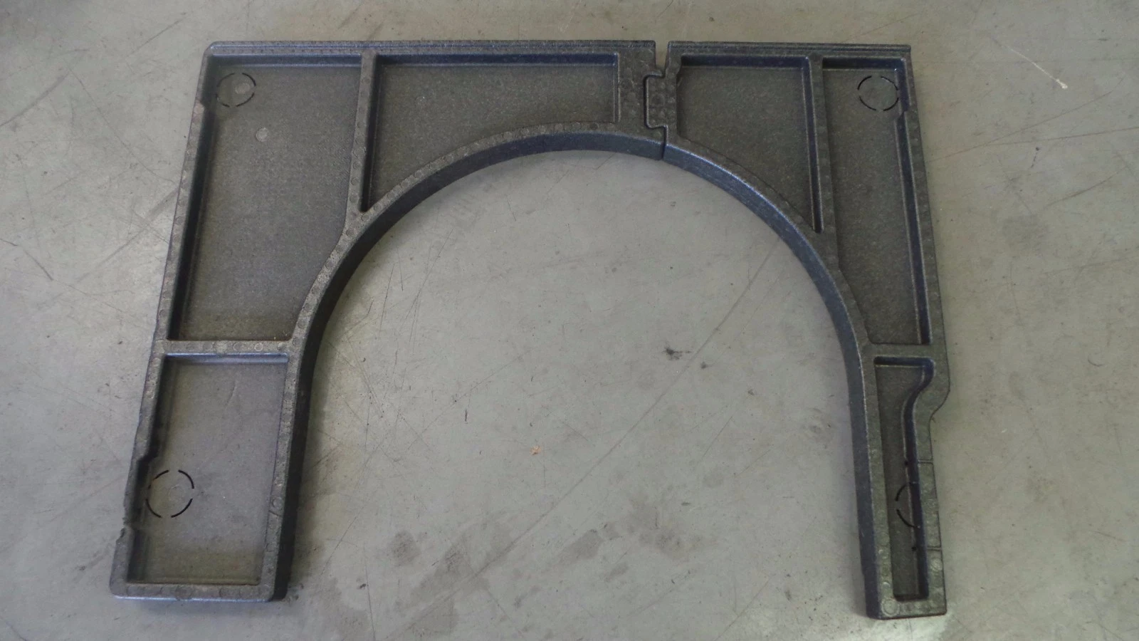

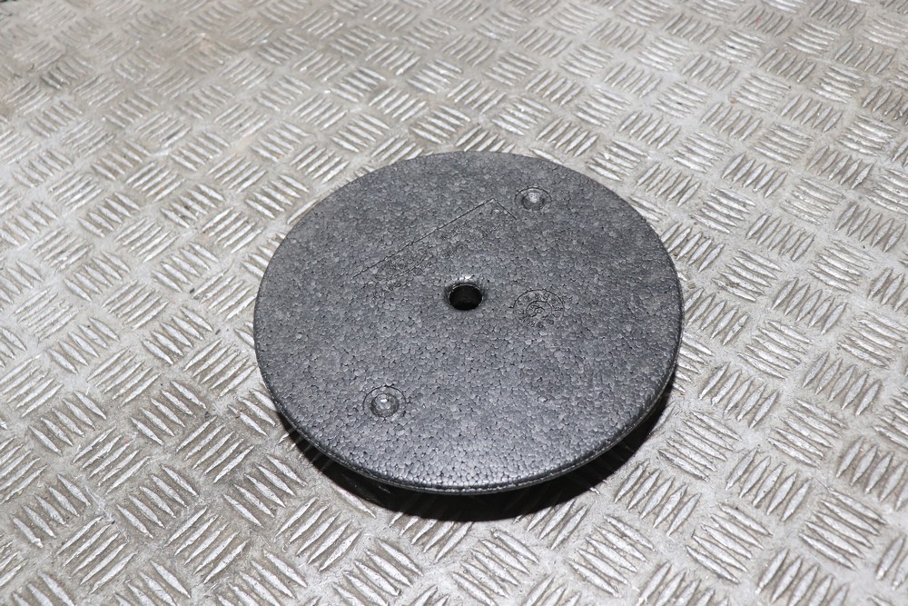

For a MK3/MK3.5 Hachback the following foam surroundings are required to fit a space saver wheel:
These to raise the boot floor.
And this one on top of the space saver wheel.
The estate has a deeper wheel well and does not require foam to raise the boot floor when a space saver is fitted.
