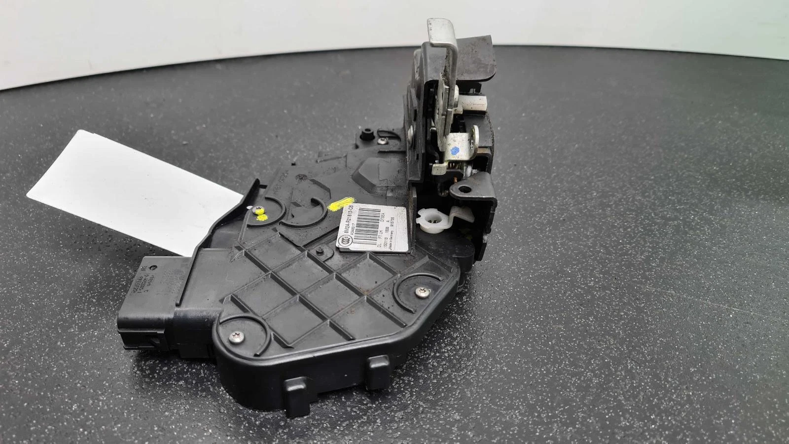

this is the part i replaced
Yes that's right 👍.  Was it the exact same part number ? there are a possible 3 versions for your car and they are not all interchangeable.
If it is the correct part number then I would say the next thing is to use FORScan and see why the car thinks the door is open.

which part of this is the actual part number?
6M2A-218112-MB
The last letter 'B' can be the same or higher, but you can't use 'A'
For example: https://www.ebay.co.uk/itm/155986926620
Thanks,
MB is the "original" and I've replaced it with a MC but as mentioned that's not working either
