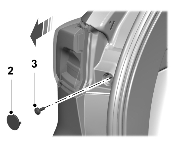

I'm new on here can someone help with a ford kuga vignale 72 plate and how to remove and change the drivers side rear outer light (on wing not tailgate ) please?
Thank you
Looks like one single screw hidden behind a cover in the gulley around the hatch.
imagen2.dll?w=600&id=E307886_EUR&t=JPG
