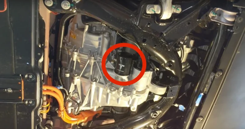

Many if not all EV's require oil change/service, including Tesla.
The EV drive unit uses a lubricant, typically Pentosin ATF 9. While not an "oil change" in the traditional sense, the drive unit does require periodic maintenance, including changing the gearbox fluid and replacing the oil filter.
Yes, that makes perfect sense. That screen message is a bit confusing!
Yep. I have seen on the internet/FB a joke or meme about Teslas needing an oil and filter change. However it is true, they do have filters for the gear unit/transmission. Some have 2 filters, one for each pair of driving wheels. (front and rear). However from what I've read, it only has to changed every 100 k miles.
Tesla-oil-filter-4-F94-DCDD-0412-4-D69-9
Sorry to OP for going :offtopic:
It's not an actual set in stone interval but the car will normally determine when it needs doing and as a general rule it works out between 50,000 and 60,000 Miles. Cost for the service kit for a model 3 is approx £525
