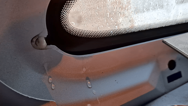

To investigate I took apart the trim and poured water down the roof & around the c-pillar window. Eventually I found that the leak is coming upward, from a gap in the seam between two body panels:
I can't imagine it's the vents, as this is high up, and I was pouring water on the side & top only amd the car was stationary. It may be the C-pillar window having developed small cracks, but from the inside it's not the cracks that leak. And the seam at the top of the hatch, between the rear panel and roof, has been sealed, as have the struts that carry the rear hatch.
So I'm at a loss. Has anyone seen something similar?
The roof joint sealing looks like it has failed
Is there a gap between the roof panels where the roof rack rail is, or only at the back?
Guess my next question would be how to remove that rail to have a look.
