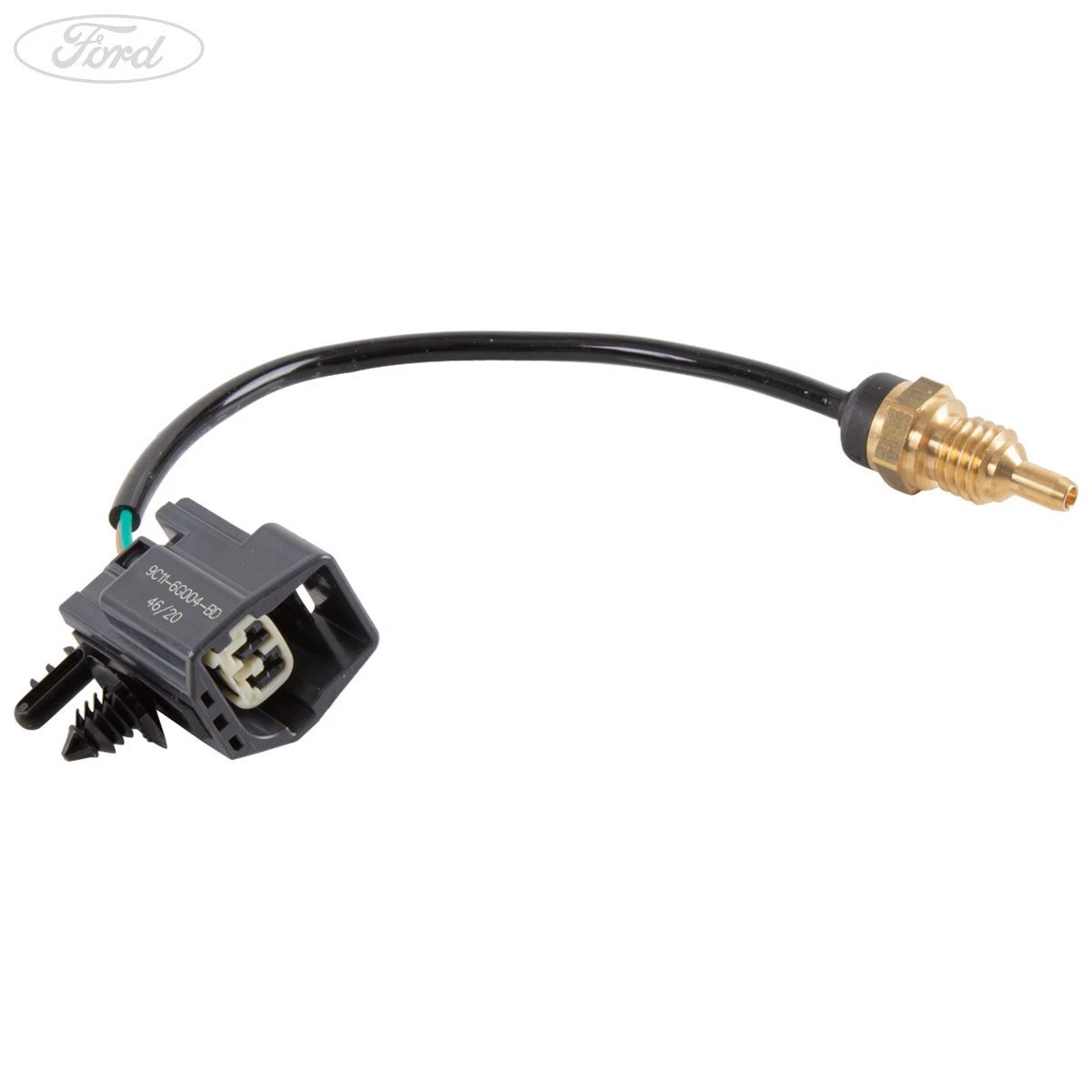

Won't see it on a picture like that.  Too much other stuff in the way.
Should look like this if you have the sensor fitted.
Genuine Ford Sensor 1770524 | eBay UK
Genuine Ford Sensor 1770524 - Picture 1 of 6
I already replaced that one
