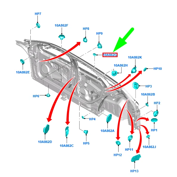

My car is a Ford Focus Estate 2015 and I m having a leak in the roof.
I m struggling to find a grommet/plug replacement which goes under the roof trim.
There are 4 on either side which are intended to be removed if you put on a roof rack.
I tried alternatives but cant find the exact piece anywhere online.

Hi,
I think it's these two. Though neither have a real life picture to confirm unfortunately.
Front (10A862F) - Genuine Ford Plug 1711369 | eBay UK
Rear (10A862G) - Genuine Ford Plug 1711368 | eBay UK
FORD FOCUS MK3 C346 Body Plug BM51-13K732-FB 1711368 NEW GENUINE - Picture 1 of 2

The part was exactly what I needed!
It was slow to come and just arrived today but fit perfectly. Let's hope it keeps out the water 🙏
