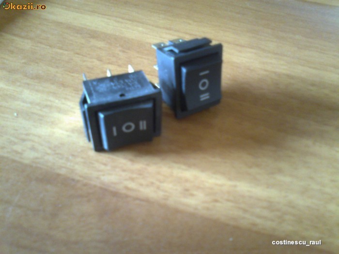

Is it mandatory to have a 6 pin 3 way switch or a 3 pin 3 way could be ok.
Like this one:
The switch must have 6 pins. It can have only 2 positions but must have two poles. You must have the can-H and can-L of the module in the middle pins and then the HS-CAN can-H and Can-L on one side and the MS-CAN CAN-H and CAN-L on the other side. If you see the electric scheme on the first post the idea is to be able to connect the module to the MS-CAN and to the HS-CAN.
Ok, thank you for the explinations nuno8210, I will search for the 6 pins version than.
Something like this:
Just search e-bay for DPDT Switches - almost any one that comes up will do
