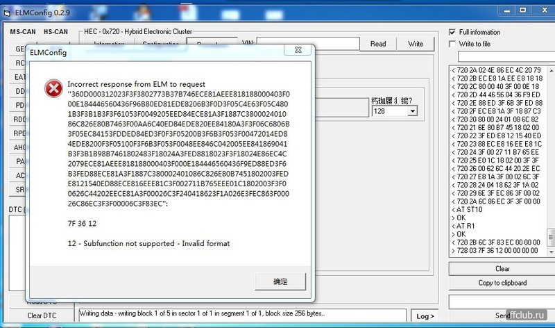

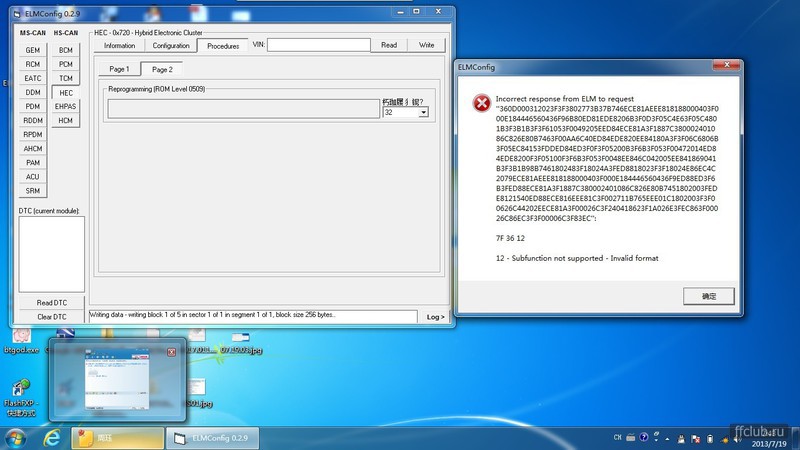

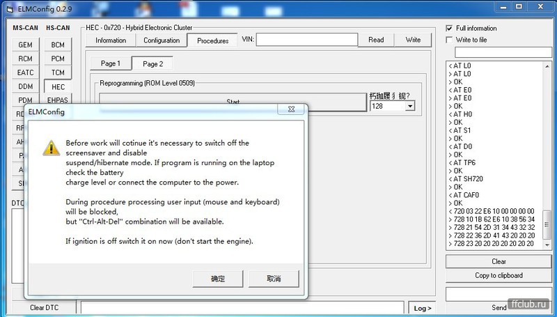

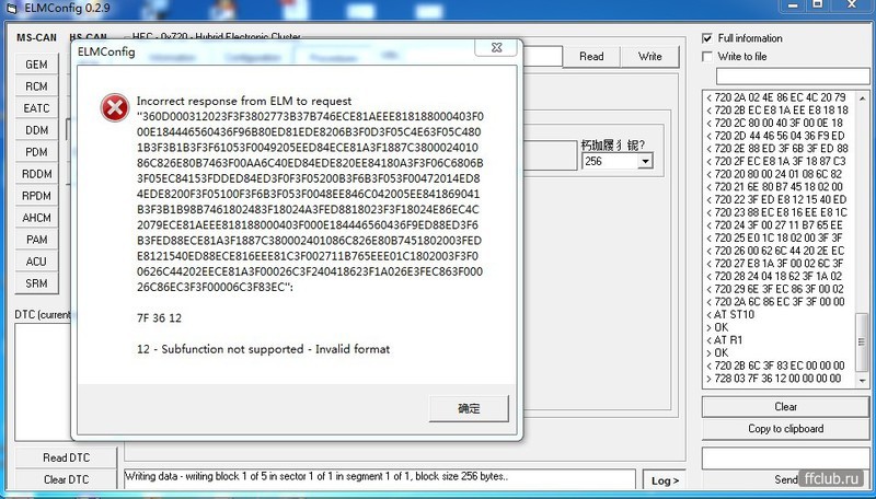

Hi Preee,
I have tried again without connecting to car. The only way I can carry out the speed test is if I set the speed to 38400 in the first screen (next to Com Port) any other higher speed fails.
I carry out speed test and 500000 is ok (screen shot) set adaptor constant speed to 500000. next screen is the hard reset (screen shot) click OK. 'New speed was set reset adaptor to apply settings' (screen shot) I press OK and it all shuts down. I restart the speed is set at 500000 connect to car, ignition on, go to open port and it fails (see screen shot).
I think the adaptor may be the problem but if you can though some more light on this before I use the link you sent me I would be most gratefull.
Thank you

Have you already tried to remove the positive battery cable for about half an hour?
If removing the battery cable does not solve the problem you can try to remove the instrument cluster from the car, connect it directly to a (12 Volt DC) power source and the ELM327 interface and perform the firmware update again . Sometimes this will solve the problem.
If performing the update outside the car also does not solve the problem there are only a few possibillities. You can buy and re-program another (either brand new or already used) instrument cluster or take the current (not working) instrument cluster to a specialized company for repair (if possible).
I own an instrument cluster which has similar problems like yours. It came from someone who tried to perform the firmware update and aborted the update before it was finished. Afterwards the screen turns black and nothing seems to work. The guy who did this had to buy and re-program another instrument cluster because he needs his car every day. Until now I have not been able to get it to work again.
hello JW1982
I made inquiries in Europe and Asia are Visteon manufacturing, I used FTDI chips ELM327 USB, the connection speed is 500,000, but not be able to program success HEC 0509rom, where do you think there is a problem? Thank you
Try setting the speed to 38400 for the HEC upgrade , 500,000 speed is for the PCM upgrade.
The second point is there are many Rom's and your Asia Rom may not be compatible with a European 0509R ! Be Carefull !
