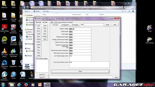

Then when I press the read to see the information in the GEM it just looks like this.
40929-9c110e33ff92026e95aad55ad0bd6710.j
Have tried to switch between High speed and low speed.

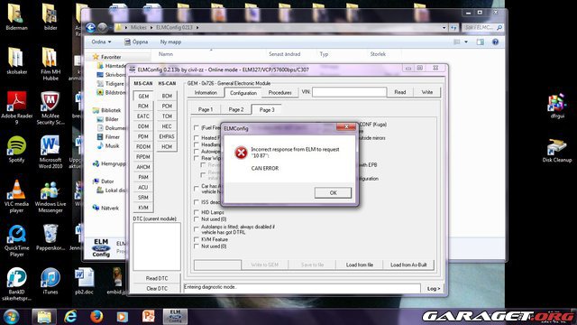

then when I press the read to see the information in the GEM Page3, I get error messages. see the picture.

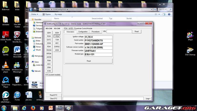

Also CC might not have been written into the PCM just like its not on the ST as I have also tried to do this mod

take a look at 6 and 14 many be wrong way your in high cam but not low cam
