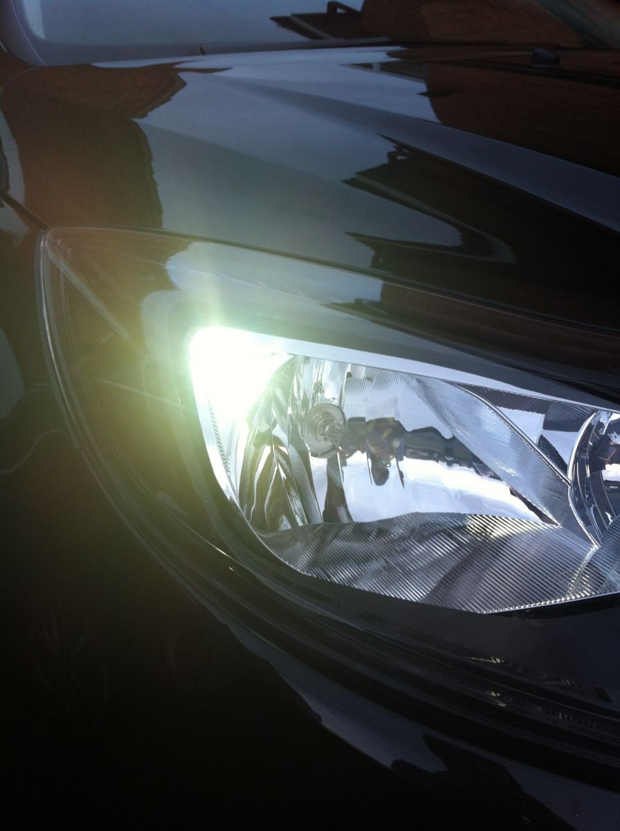

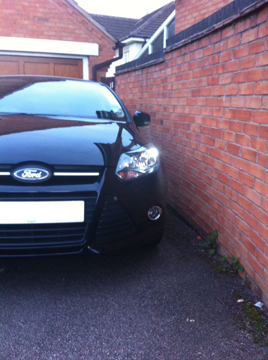

Seen a few people on here have upgraded to LED sidelights, but I've not yet seen a MK3 with them. Until now... bought a set on eBay and fitted them this evening.
Before, horrible yellowness:
Now, nice crisp white lights:
The photos don't really do them justice to be honest, they do look really smart :) Didn't even have to remove the headlights (but I now have very grazed knuckles and fingers!). Now I just need whiter headlights to match!

Hello mate, a few of us have put the LEDs on the mk3 me being one, you might have to go back a few months of topics to find it but anyway, we found that the LEDs (had 5 LEDs pointing in different directions) within an few weeks/ a month say 4 would have gone out and the rest would flash leaving you looking like a police car (theres an up side haha) somebody said it was to do with the heat from the main bulbs. But keep me updated as they do look the bees knees when they first went in.
Yeh I had read that to be honest but thought I'd take the plunge, they weren't expensive. I'm gunna keep the originals in the boot so if they do let me down I can quickly pull them out!
I'm hoping they'll be okay, as you say they do look the part :)
First time I've actually been tempted to do this. Looks much cleaner
If they start playing up you can put them in the boot each side there is a bulb and they are the same lamp, don't know what they would look like at night as mine had a one way ticket to the bin.
Done mine when i first got the car, massive difference
