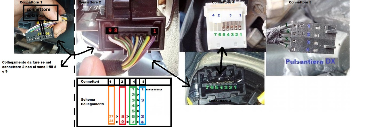

Follow your introduce, I bought a Cruise control kit to retrofil CC of my FFi bellow:
And after removed air bag look like this:
Thank to introduce connect red wire, yellow wire and blue wire from Cruise control switch with which slot?
Many thank
drop iNath a PM as I know he has done a few fiesta upgrades, he could probably tell you without thinking about it!
Here's the schematics:

Hi
the link for schematic is dead.
Is someone have this schem  ?
Many Thanks in advance
New URL to schematic:
https://postimg.cc/4HhGRSP0

Yeah hi! Really interesting discussion you guys have here. So to be clear. There is no need for an external module in order to install cruise control? In my case, a 2013-14 Ford Fiesta Titanium (That should be an mk7). A steeringwheel with the the buttons is enough + some sofware? And ofcourse some cabels to connect to the vehicle. I hope you dont mind me asking how much this cost you as I can get it done for 430 euros in Denmark.
