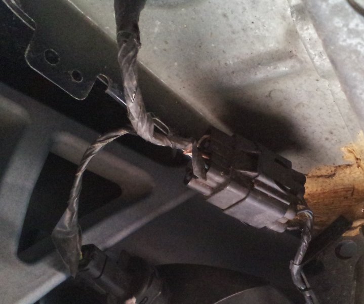

I have ford focus 5 door hatchback under the rear bumper driver side there is a plug and I would like to know what that one is for

What year is your car?
If it's 1999 to 2011 it's likely to be the fog light connection.
Have you checked that your fog light is working?
The fog light is connected and working
I was hoping for towbar wiring but still not sure!
If you do have reversing sensors I'd say most likely for that, probably one connector has come adrift from it's sensor connection.
I haven't any reverse sensors but it's most likely it is there than for that!!!

Is this the plug (pic from underneath my car) ?
If so it's for the factory fit Rear Parking Distance sensors and the cable colours are :-
White/Red, White/Blue, White/Green, Brown, Yellow, White.
Yes that's the one, thanks for your help
