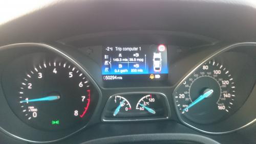

Morning All,
In the last week or two I have noticed that my coolant temp on my dash is only reaching a quarter (75 degrees I think), this is after a long drive on A and B roads (50 miles in total), I notice that that the temp is -2 but it's been doing the same for the temps starting at 8 degrees...
The only time I notice it goes up is 10 minutes of stop start traffic...
I have the Ford Focus MK3.5 Titanium X 1.0 125 Ecoboost (2015)
Any help would be great...
I had a service a month a go, not sure if it's been happening since then... I will say I am not really a massive under the bonnet expert lol
Cheers
Simon

its warranty , just take it in.  the temp guage isnt a very accuate indication of temp. get the car to your normal temp as showing now, then stop car, and go in to instrument cluster test menu,(press and hold ok button on steering wheel ,then  switch ign on) scroll through to ect temp. then see what that reads.
Now that is a great bit of knowledge! Just went into test mode and and the car is showing as 66 degrees (90 degrees being in the middle) after a 10 mile dash up the dual carriageway, I will get it booked in to be checked out
Cheers for your help
SImon
thats confirmed that the thermostat is opening up too early.
